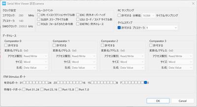

Serial Wire Viewer -> Enable: On

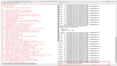

When capturing with SerialWireViewer during debug execution, the program ends unexpectedly, causing the results of the Google tests running within the firmware to be interrupted.
 attached file: ConsoleErrorMessage.txt
image_error

SWV ITM Data Console

After analysing the error message, there is a problem with the connection between your debugger and the target microcontroller.
