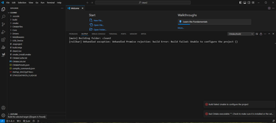

Now I am using VSCode with STM32 extension V2.1.0, at beginning is used well. but 1 days later, when I opened the VScode and try to build my code. it shows
"Unhandled exception: Unhandled Promise rejection: build Error: Build failed: Unable to configure the project {}"
then I want to close the folder, it cannot be closed.
so I copy it to a backup folder and delete the project. and copy back and use [Import CMake project], the VSCode just always importing. you can see as below
why? why cannot import the project?
thanks.

when I open the folder and try to build, the result is as below
what is the problem? 1 day before it was ok, but now cannot build.

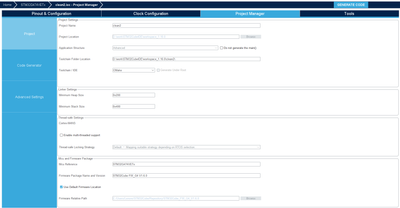

I re-generated the project with STM32CubeMX, below is my setting.
you can see I used CMake.
and I re-import, it is still the problem. no solve. do you have any other advice?
