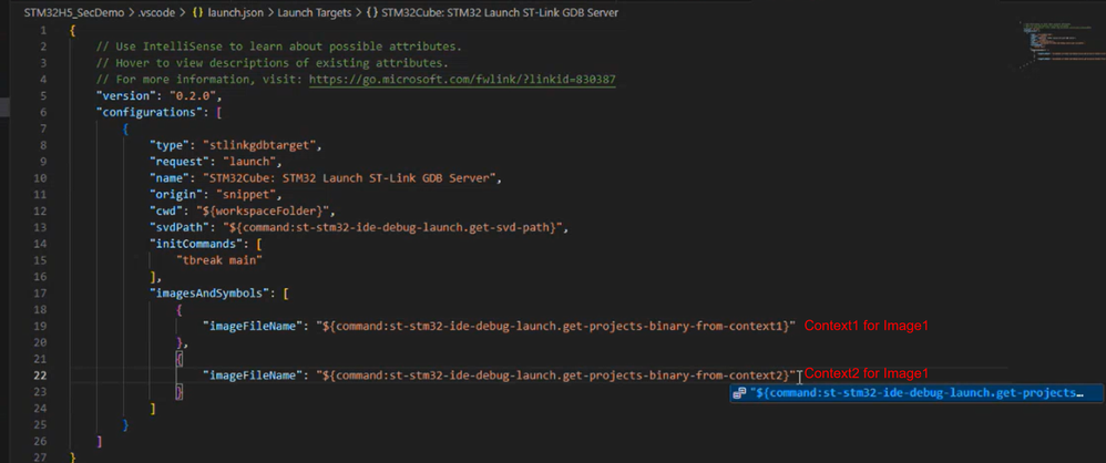

Using VS Code, you should flash 2 images starting from the non secure than the secure one!
First, you have to build the project to have the binaries then the images that will be flashed to the MCU can be found in the launch.json file as follows (modify the launch.json file to add the 2nd image context)
Please note that the first context to be flashed is the NS one, the 2nd context is the Secure one!
This configuration can be stored so the next time you debug a secure project, you don't have to flash the MCU in that specific order, you just select the securedebug config

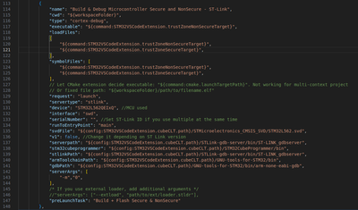

Thanks for your answer.
My lauch.json file is quite different from yours, but it looks like the "symbolFiles" are already in the right order.
I also tried to set "executable" to the SecureTarget, but still not running.
Note: I am working on Ubuntu 24.04

Regarding the default six configurations;
Try using Build & Debug NonSecure Microcontroller - ST-Link first then Build & Debug Secure Microcontroller - ST-Link
