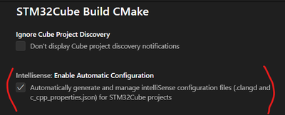

In the meantime, You can try to disable the following setting to avoid configuration files regeneration:
But be aware you will also loose some automations updating compile_commands.json path, based on CMake configuration context.
