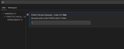

Hi @luxae
could you please open VSCode settings type CLT and check if the correct path is set here ?
2024-04-18 3:39 AM
Hello Nawres,
Yes, I've reconfigured the CLT path and now it's working. However, it only worked after compiling in Debug mode. Thanks for your help.

I'm hitting a similar problem. Can I ask what the correct path should be? I have installed the CLT (RPM package), but could not find an executable named "stm32cubeclt". The files the package installed are in "/opt/st/stm32cubeclt_1.19.0". Using that path does not work.
