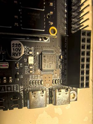

2025-08-18 8:21 AM
Welcome @jiangkoumo, to the (English speaking) community!
What type of ST-LINK are you using?
Could you please include a photo of it, and if it is in a plastic case, please include a photo of the back as well?
Regards
/Peter

2025-08-19 6:16 AM
是自己设计的板子上板载的stlink,用的f103cbt6芯片做的,使用的stlink-v2的固件

2025-08-19 10:40 AM
If this is your own board and you want to build your own ST-LINK/V2 with an STM32F103, it CAN'T work with the software from STMicroelectronics. The ST-LINK firmware is subject to copyright, not released or available for self-built ST-LINKs, copies of this firmware are illegal and are understandably not supported.
STLINK-V3MODS are available for just such applications, which you can solder onto your own board. At least then you are not using illegally copied software.
Regards
/Peter
