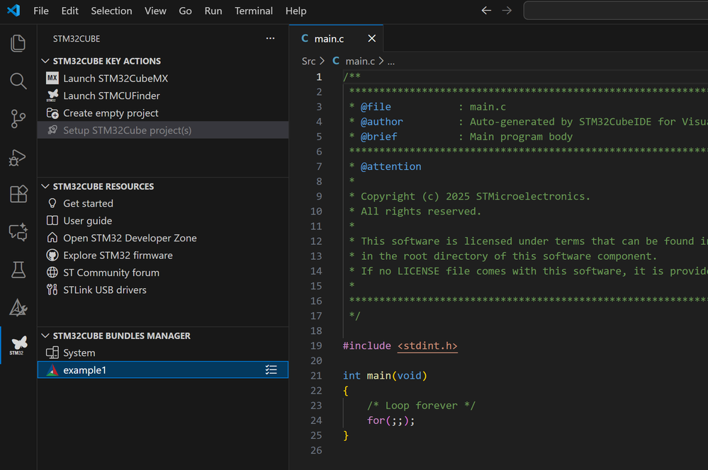

I installed STM32Cube for VS Code extension and then created an empty project.
But the "Setup STM32Cube project(s)" on the STM32CUBE KEY ACTIONS is still in gray color.
Is there something that I missed?
My environment is as follows.
- Windows 11
- VSCode: 1.106.3
- STM32Cube for VS Code: 3.6.4

Hi @JaeLee, there is a known issue with this action enablement, did you clicked at some point on the Don't Show Again option of this notification ?
If so it checks this setting for you which unexpectedly disable the action.
It will be fixed by the upcoming version.

2025-12-07 8:38 PM
When I restarted VSCode, this was resolved.
