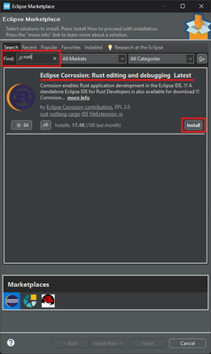

Well if you want to stick to STM32CubeIDE, there is a Rust IDE made by Eclipse : Rust Corrosion. Since CubeIDE is base on the Eclipse framework, you can install Corrosion from the market place: Help > Eclipse Marketplace...
Then search "rust" and install it:
I've never used it but it looks like you can build and debug with it.
I let you try it out and see if it works for you.
I'd be interested in a feedback.
