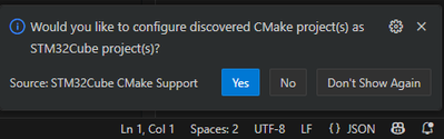

We approach this from a dual perspective. Our rationale is that VS Code is an open ecosystem, and the CMake Tools extension is highly popular. Furthermore, not all end users are solely dedicated to STM32 application development.
For this reason, when the CMake Tools extension detects a CMake project, we prompt the user with an option to enrich it as an STM32Cube project. We cannot force this enhancement, and we anticipate that automatically warning users about the absence of a CMakeLists.txt file at the project root would be disruptive or cumbersome for a significant portion of our user base.
Once STM32Cube project granted we may already promote some information like.

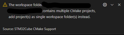

"Add project(s) as single workspace folder instead" - what is the meaning of that exactly? Something that the user should do or the extension is about to do?
2025-11-12 10:51 PM
The suggestion to "Add project(s) as a single workspace folder instead" is kindly advising you to use multiple "Add Folder to Workspace" actions, resulting in a multi-root workspace. This approach is recommended when you have multiple top-level CMakeLists.txt projects, rather than adding a single top-level root folder of the entire file system.
To clarify, referring back to @ankes - Thanks for sharing - example: https://github.com/anttikes/usb-fm-radio/tree/cmake-test, the advice is to add two folders to the workspace separately—one for the Firmware project and one for the GUI project. These are independent projects from a CMake perspective.
However, if you use the single top-level CMakeLists.txt approach as in https://github.com/anttikes/usb-fm-radio/tree/cmake-test-in-root, where Firmware and GUI are subdirectories of the same project, then adding just one folder to the workspace is appropriate and no warning will appear.
In summary, this notification is a helpful suggestion to guide you towards the current best practice. We remain open-minded and encourage feedback, as we are working on improving support for multi-context projects (e.g., multicore, TrustZone, application & bootloader).
