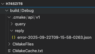

Hi @Gopmur,
Do you have any error with the CMake file API, like:
Do you have cmake natively installed on you computer outside of the STM32Cube for VSCode integration ? If so which cmake version ? To check it simply open a native terminal (bash on Linux, CMD/PowerShell on Windows, Terminal on Mac) and enter cmake --version.
