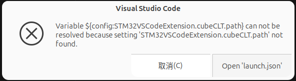

Newly installed Ubuntu 25.04
Newly installed VSCode with STM32Cube for Visual Studio Code(preview)
The project generated by STM32CubeMX can be compiled, but cannot be debugged.
