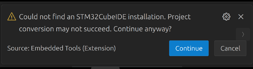

So new Machine fresh install of 23.04 and we now get prompted when we
press the import button

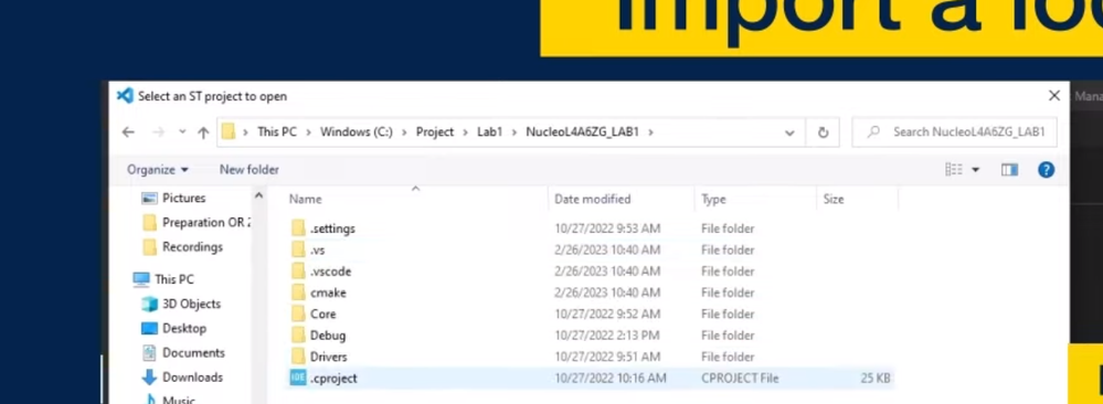

But the filter on the open file dialog is ST projects. Which I had no idea what the prompt meant as the project created in STM32CubeMX has the extension .ioc and this is not correct.
Than I remembered there was a video on how to use the extension found https://www.youtube.com/watch?v=Yhqsh8h_meE
So I am looking for .cproject. This leads me back to STM32CubeIDE.
I attempt to install it but it insists I need the 3 year old dead project libPython 2.7. I manually build Python 2.7 but the install clearly wants the dpkg and not just the software.
So I install the non debian package en.st-stm32cubeide_1.12.1_16088_20230420_1057_amd64.sh.zip on my ubuntu and this does install but this crashes when you start it with an error
