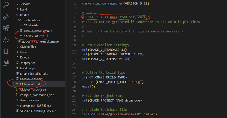

Just in case somebody else hits this issue, the STM32 plug-in handles this issue by providing 2 CMakeLists.txt files as shown below. The first (top) one is modified when you execute STM32CubeMX and the second one is for user additions and is only generated once as stated in the header.
I am sure this is described in the manual but you know how it is.....
