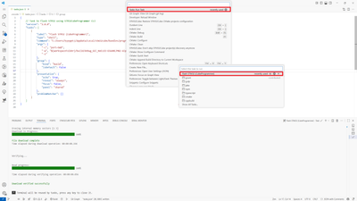

One of the options is using "task" as shown below:
2025-11-05 9:38 PM
Thank you very much, it works very well. Have you considered integrating it into an extension in the future? I feel it would be very useful.
