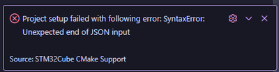

I'm trying out the new STM32CubeIDE extensions for VSCode and have generated a CMake project using CubeMX. I'm unable to setup my project as I get this error:
I don't know what JSON file it is referring to as there are none in my project except the auto-generated CMakePresets.json, but I don't think that's the issue since I get the same error even if I remove that file.
I have tried to re-install the extensions and restart VSCode with no luck.

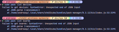

Neither command seems to work:
Same error message from the CMake plugin:
I'm not entirely sure what's going on. I have seen the issue in both WSL and Windows. Can it be something like unix/windows line endings that trips up the plugin?

Sorry for the late reply; I was out of the ST Community context for a week.
These two commands indicate an issue with the communication of one of the core utilities named cube-cmsis-scanner. This service runs in the background, listening on port 32125. I wonder if there was an issue starting the process (port already bound to other process, other anything else).
Could you try launching it manually with this command:
cube cmsis-scanner --launch-service
If it fails, please paste the error here.
If it works, please try the two previous commands again in a separate terminal.
If the failure is due to the port already being bound to Hyper-V or WinNAT, such as:
CLIENT: Failed to bind 127.0.0.1:32125: Os { code: 10013, kind: PermissionDenied, message: "An attempt was made to access a socket in a way forbidden by its access permissions." }, assuming our service is already runningThen you can try to reserve this port for other applications with these Windows commands:
netsh interface ipv4 show excludedportrange protocol=tcp
net stop winnat
netsh int ipv4 add excludedportrange protocol=tcp startport=32125 numberofports=1
net start winnat
