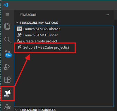

Hi Paul,
Your first error indicates that the device core cannot be found automatically.
The project setup was likely incomplete. Therefore, please execute the command "STM32Cube: Setup STM32Cube project(s)" via the command palette or thanks to the menu in the STM32Cube activity bar (recommended solution):
Alternatively, you can add the "deviceCore" attribute with the value Cortex-M7 in your case.

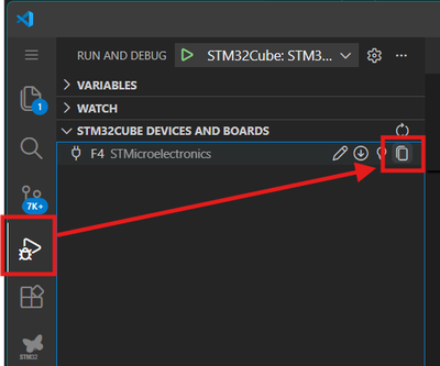

Concerning the multiple boards connected, you need to specify the serial number using the attribute
"serverSerialNumber": "<the serial number>",
the serial number can be copied in the "STM32Cube Devices and Boards" view here:
Without the serial number attribute, the debug session cannot determine which board is the correct one.
