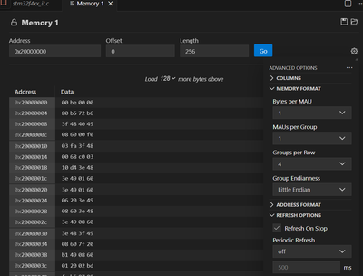

You're not relying on proper memory view.
Right one is :
You're on :
Let's check CDT one is installed and call it Thanks (takes care this view is only available having a debug session active)
2025-12-10 12:59 PM
Has to look like

@MGogr.1 not sure to understand your question here. Yes i'm able relying on CDT extension. I've shared snapshot of view running above.
