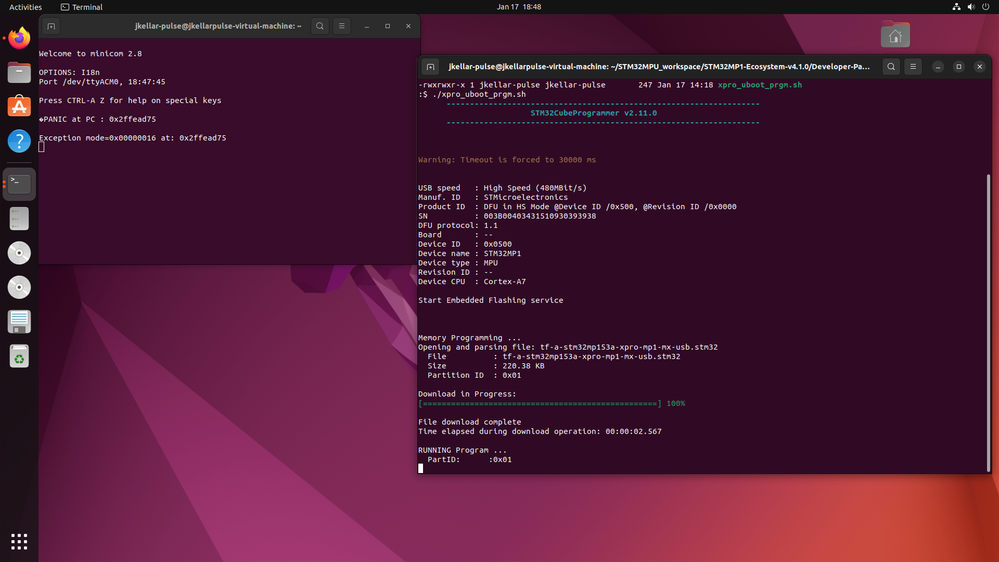

2023-01-18 7:05 AM
Here is a screenshot showing programming and the crash if this provides any further information. Minicom is connected to UART4 from the MPU.
2023-01-18 8:31 AM
Hi @Community member
This kind of crash during Flashing is maybe caused by an I2C STPMIC or DDR issue (TF-A run from SYSRAM and initialize STPMIC using I2C to power-up and init DDR in order to load uBoot on next step).
See https://community.st.com/s/article/FAQ-STM32MP1-Bring-up-procedure
Regards.
In order to give better visibility on the answered topics, please click on 'Select as Best' on the reply which solved your issue or answered your question. See also 'Best Answers'
2023-01-18 8:33 AM
Hi @Community member ,
Such an early Panic in TF-A usually highlight about a wrong Device tree settings, for example at clock level.
You might find on this community post about similar issue :
for exemple :
If you don't find the problem please share your TF-A DT
Hope it help,
Olivier
2023-01-18 8:42 AM
Thanks Patrick and Oliver your responses are spot on. After posting this I stumbled across those links you proposed and yes this is the likely cause but not due to clocking which I thought at first but I2C4. Apparently TF-A defaults to expecting a STPMIC to be connected to I2C4 which on my target I'm not using. This link as well provides some guidance on this - https://st.my.site.com/community/s/article/FAQ-STM32MP1-bring-up-troubleshooting-guide. I just need to find a way to disable the use of STPMIC by TF-A.
