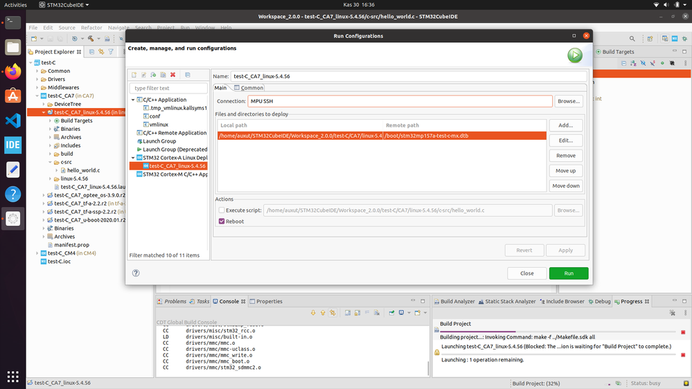

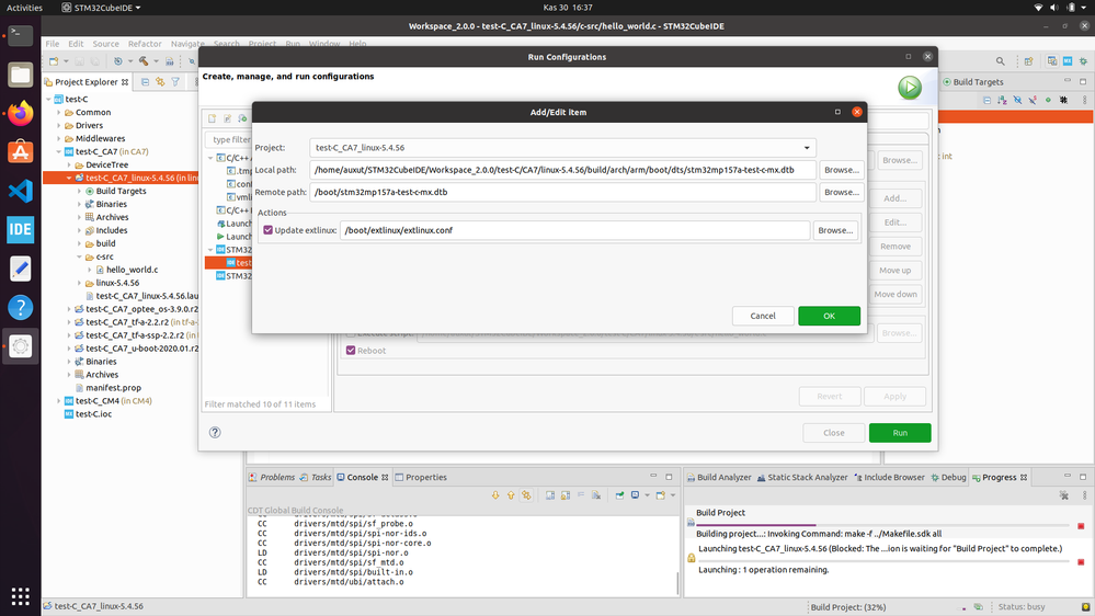

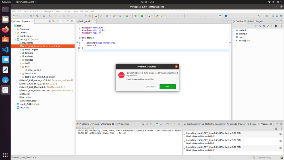

The problem is when i press : Run as -> STM33 Cortex-A Linux deployment it gives an error and says : " Activation DeviceTree... failed"
 0693W000006E2RVQA0.png0693W000006E2KfQAK.png0693W000006E2KfQAK.png0693W000006E250QAC.png

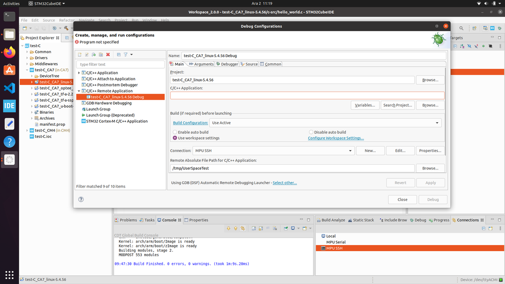

Hi @Mustafa Çerçi​ ,
Seems you are not using the correct Debug Configuration .. your userspace app is then consider as a DeviceTree.
Select your project, right-click Debug as... > Debug Configurations.
Then create a C/C++ Remote Application debug configuration, double clicking on it.
Hope it help,
Olivier

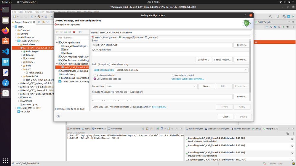

Hi thanks again for the fast reply,
Then what should i choose other settings? do i have anything else to do because it seem like not working (sorry if i'm being annoying)0693W000006E89DQAS.png

Hi @LudovicR​  read and tried it, but there is a problem i dont have that Debug folder. What should i write C/C++ Application tab? In this tutorial it says Debug/UserSpace.elf, i assumed i need to have something like Debug/test-C_CA7.elf (for my project) but i dont have that folder/file0693W000006EIJmQAO.png
Ok i figured it out generating and generated Debug folder and .elf file also i can debug my C project, only one problem remains. I want to use linux header files like "spi.h","spidev.h" and i need to work on ARM Cortex A7. With in this context, can i import linux project into my C project after that can i import this project into an STM 32 project to use in inside CA7 ?
