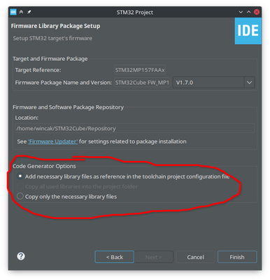

I found two ways of resolving this problem:
1) Do not copy files from the package, reference the package instead. This option can be selected when creating a project:
2) Manually copy the missing files and add include paths as necessary. Unfortunately running "Generate code" will overwrite all manual changes.
I've tried option 2 and after fixing some problems like conflicting SysTick_Handler definitions got the code to at least compile.
