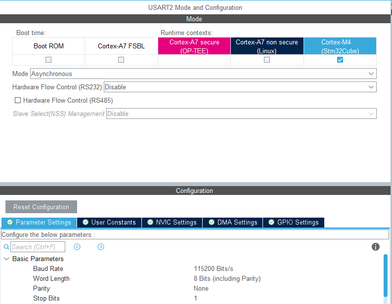

What I did was enabling USART2 in STM32CubeMX :
I did not change any other configuration and simply regenerated the code. Then I used these functions:

However, when I use the Open console on MPU serial device I get absolutely no ouput.
It seems that UART is blocked on the UART_WaitOnFlagUntilTimeout in the stm32mp1xx_hal_uart.c.
Did I do something wrong or is there a simpler method ?
