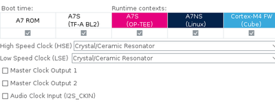

Found this topic: The external clock of our board is a crystal, and DK2 is an oscillator. After setting the TF-A DT clock correctly, our board can boot BL2 until U-Boot.
Tried all different settings with Cube MX: Crystal, Disabled, Bypass but nothing works to fix the panic after Cubeprogrammer transferred partition 0x03 Fip-boot and then shows a "reset". the usb connection is lost and cubeMx dumps a bunch of warning dialog boxes.
This board uses also a crystal, but the link mention on many replies from st: https://wiki.st.com/stm32mpu/wiki/Clock_device_tree_configuration_-_Bootloader_specific is broken. Reported this several times but no one is helping ?
CubeMX is set correctly for crystal:
T-FA DT:
When selecting"bypass" in CubeMX the following is generated
clocks {
/* USER CODE BEGIN clocks */
/* USER CODE END clocks */
clk_hsi: clk-hsi {
clock-frequency = <64000000>;
/* USER CODE BEGIN clk_hsi */
/* USER CODE END clk_hsi */
clk_lse: clk-lse {
clock-frequency = <32768>;
/* USER CODE BEGIN clk_lse */
/* USER CODE END clk_lse */
clk_hse: clk-hse {
clock-frequency = <24000000>;
/* USER CODE BEGIN clk_hse */
/* USER CODE END clk_hse */
Is this right ? How the select bypass so that it generates:
