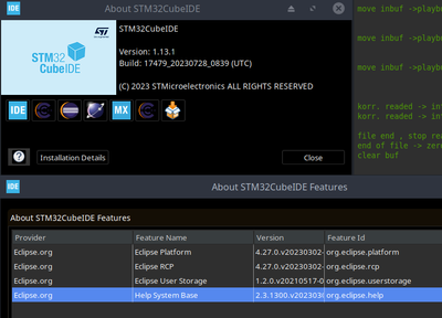

--- dont believe ...just look:
+ edit box:
and problem may be : destroy start of string , using backspace.
this eclipse/java sh.t can make some surprise:
