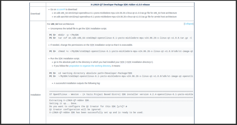

i have downloaded the developer package
so the steps i followed for developer package was
i downloaded the MP1-DEV-x86 from st website
For x86_64 host architecture i Uncompressed the tarball file to get the SDK installation script. and Ran the SDK installation script.
for x-linux-qt developer package i downloaded the below file(but my board is stm32mp157d-dk1)
i followed these steps
does this bellow sdk add on work only with stm32mp2

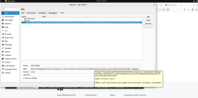

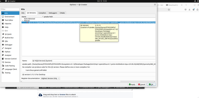

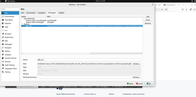

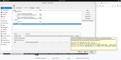

2024-10-14 3:22 AM - edited 2024-10-14 3:23 AM
i am setting the qt kit manually using developer package for stm32mp157d-dk1 but not able to do
