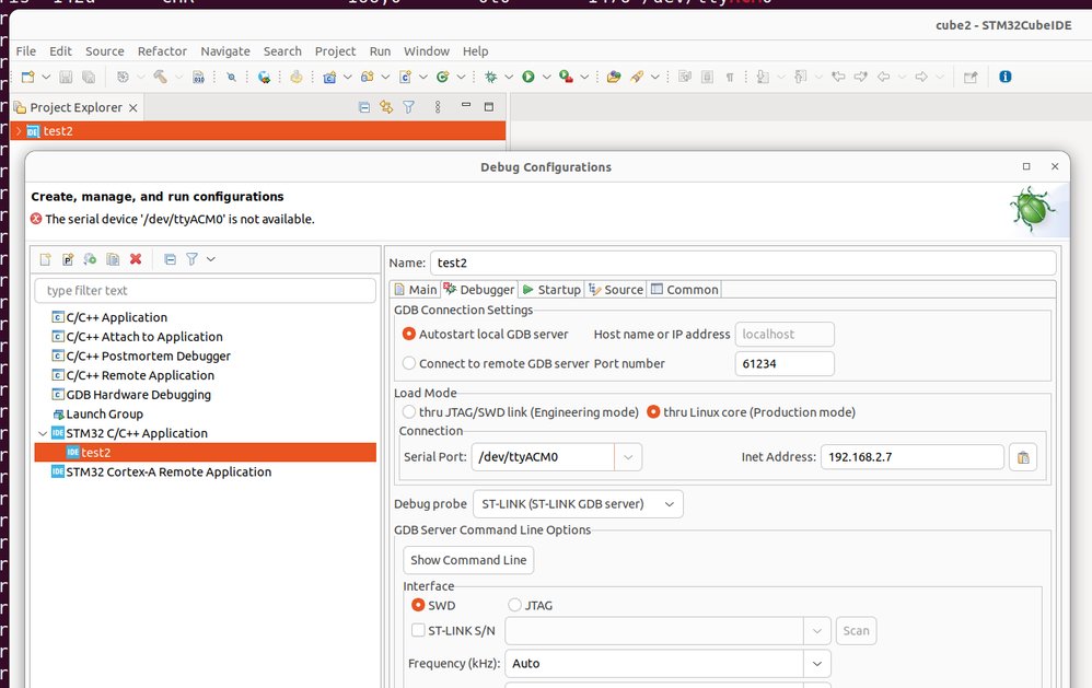

I'm experiencing the same or very close to identical problem, attempting to set up debugging on the M4 in production mode.
In short, the STM32MP157 board's UART shows up on my Ubuntu 22.04 host as /dev/ttyACM0.
No amount of fiddling will get the debug config dialog to accept that serial port address.
However, I can open up that port in minicom, and I can also open up that port in the IDE console. I can also run "sudo lsof | grep ACM0" and confirm that the port is open when being used, and not open when not being used by minicom or console.
Can you elaborate on what steps the IDE should be taking to assess whether the port is "available" or not? Should it merely try to open the port, or is it setting the baud rate (should be 115200), and/or does it try to issue a UNIX command to the prompt at the other end of the UART (I have it logged in as root)?
Can you provide any debug logging steps to help illuminate why the IDE refuses to accept that port?
I'm going from the steps in this ST tutorial video -> https://www.youtube.com/watch?v=YIhzzgJmop0. If there is another sequence I should follow, can you link to it ?
If you have worked through this example using STM32CubeIDE latest version below, can you post a copy of the .launch file that you wind up with after successful production mode debug ?

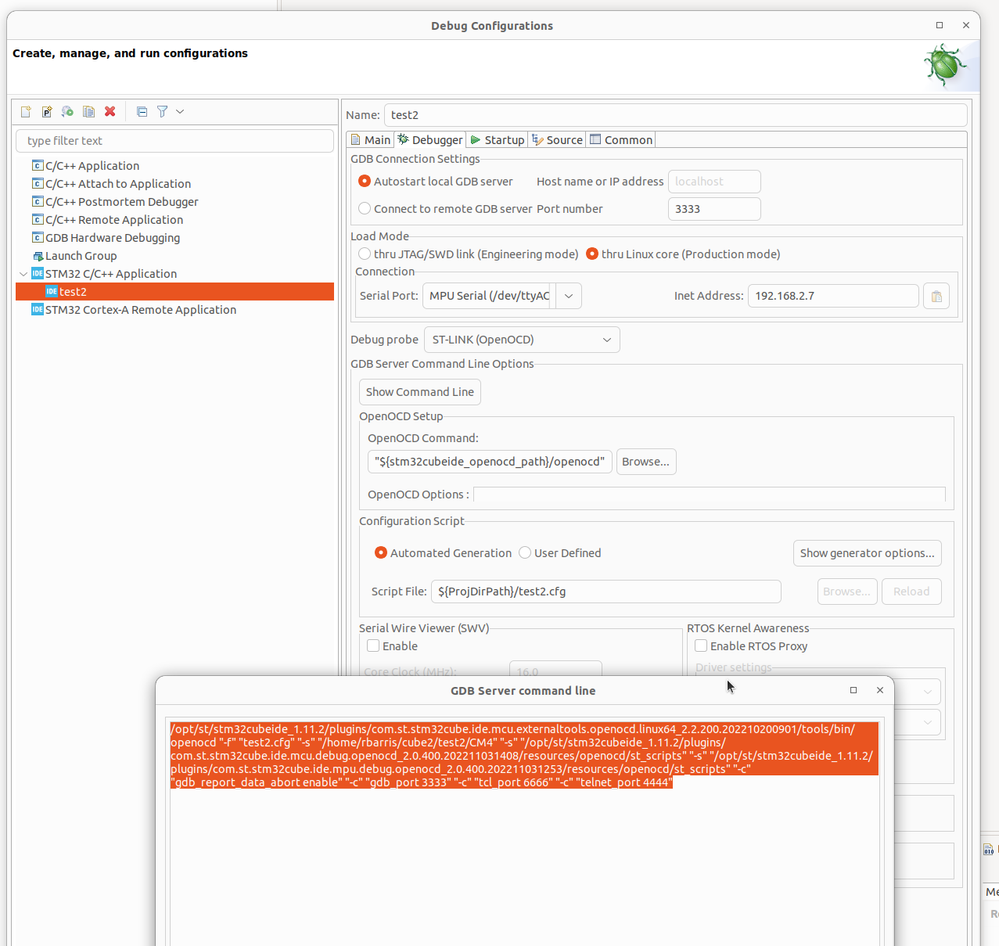

0693W00000aHZonQAG.pngupdate: I made it to the STM32MP wiki and read up on the target status widget. Using that I am able to get the correct port selected and it enables the Debug button.

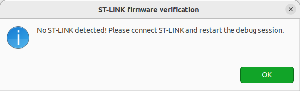

However I'm not able to get debugging to start as I get the "No ST-Link Detected!" error.
True: there's no physical STlink interface. All that connects host and board is ethernet and one USB cable. I have the "STLink (OpenOCD)" checkbox set in the debug config, matching the example video above.
The target board is a Digi ConnectCore MP15 DVK, running Digi Embedded Yocto (kirkstone build). Are there any packages that need to be present on the target rootfs for the IDE to be able to log in and start up the debug session ? What specifically is it looking for that results in the "No STLink Detected" error ?
