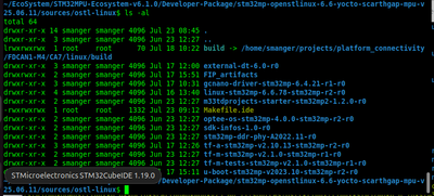

and the build directory contains a link to itself:
Here is my `ostl-linux` directory:
