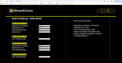

and I can only test UDP server mode (IPERF mode client)  show on picture:
All others variants end with connection errors...

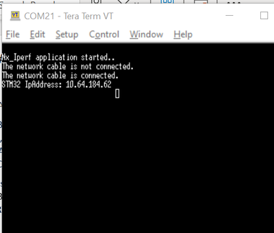

First the ethernet cable must be connected and a terminal launched.

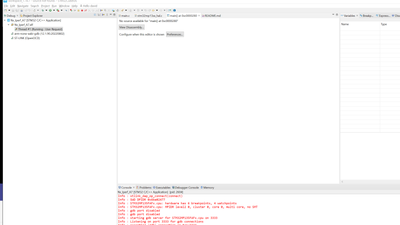

After you load the code in DDR, and resume it, the cubeIDE won't be able to show the sources:
in a terminal windows, you should see this:

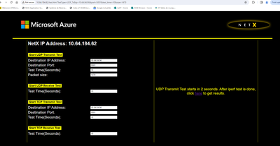

and then you can try with your favorite browser (http://IP@) thesame ip you saw in the terminal:(

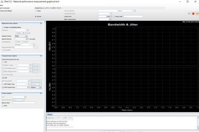

then start the Jperf tool and run it
press start UDP transmit in the web page

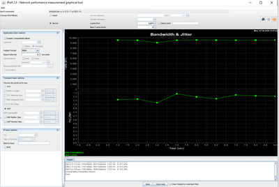

and check the jperf tool:
and finally you can check everything is OK in the browser by clicking "here" in the right pan:

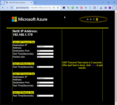

Dear @DBELL.1
Maybe there was problem with DHCP server application. I setup router with DHCP and the board get 192.168.1.179 address and web server is now running:
And now all tests are working...
Thanks... so the problem was on my side.
