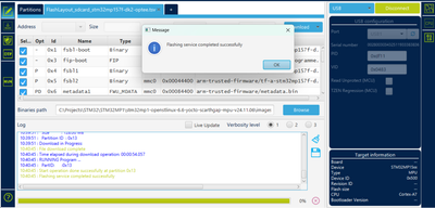

I just got the board and off course now want to follow the official page (https://wiki.stmicroelectronics.cn/stm32mpu/wiki/Getting_started/STM32MP1_boards/STM32MP135x-DK/Let%27s_start/Populate_the_target_and_boot_the_image) for flashing.
OS windows 10.
STMCubeProgrammer v2.18.0
Regards

I use official Raspi 4 (ouput 5.1V 3A 15.3W) charger which should be ok for the board.
I use windows 10 pure and no VM or wsl2. I dont see any error anywhere.
I suspect 3 things.
I flashed so far the booloader with balenaEtcher to the SDCard and this is ok I reach the u-boot.
I also did this https://bootlin.com/blog/building-a-linux-system-for-the-stm32mp1-basic-system/ and works perfectly.
So my problem is CubeProgrammer is not transferring files to the SDCard. Strange thing is why the programmer crashes and not displaying some error code? Should I try some older versions and/or install a VM and flash it from linux?

Power supply could be 5V 3A and NOT USB Type-C compliant (there is many on the market). RPi does not check this compliance as our OpenSTLinux Starter Package do (it could be disabled when you will rebuild a now image for this board or a custom board).
Could you share the board console log by connecting STLINK connector to a PC and running a terminal emulator on the related Virtual Com Port?
Btw, the link you provided in your first post is not for the right product/board (but should not make difference as in the screen capture, I see right files)

ok, so maybe a missing USB driver on the PC (I guess during CubeProg install).
Could you look at Windows Device Manager (after the 'reconnect') to see if 'reconnected' DFU is present.like this

but I ran from shell STM32Bootloader.bat I even commented the @Echo off to check which if else enters the bash script
2024-12-19 12:53 AM
Hi PatricF,
I tried to reinstall all again but no luck.
I debugged the STM32Bootloader.bat and from if else it enters the:
start "STM32 USB DFU DRIVER" pnputil -i -a %0\..\Driver\STM32Bootloader.inf
but the log I get:
pnputil -i -a "c:\Program Files (x86)\STMicroelectronics\STM32Cube\STM32CubeProgrammer\Drivers\DFU_Driver\Driver\STM32Bootloader.inf"
Microsoft PnP Utility
Processing inf : STM32Bootloader.inf
Failed to install the driver : No more data is available.
Total attempted: 1
Number successfully imported: 0
regards
2024-12-19 2:07 AM
Hi @anpa
strange as CubeProgramer should have been installed in C:\Program Files and not c:\Program Files (x86)
What result did you get if you right click on STM32Bootloader.inf file then select install ?
