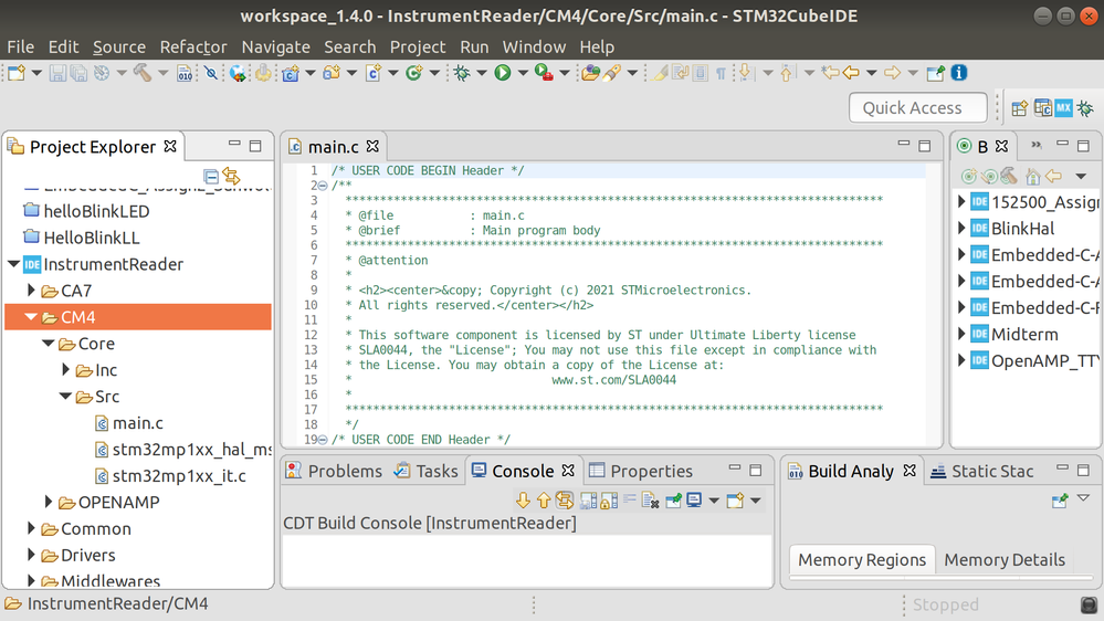

So I created a new project and selected the STM32MP157c-DK2. It loaded a .ioc configuration file but the project will not build. I don't think there is a build file but I thought that was generated automatically? I can add a debug configuration but there is no .elf to link to.
What would be the easiest way to move forward?

Do you well select and have focus on the _CM4 sub-project when you attempt to build ?
Else could you please share a screen shot of your CubeIDE "Project Explorer" when hammer button is grayed ?

Yeah I have tried it with the main.c file opened and various directories selected but can't seem to get the build button to be clickable.
