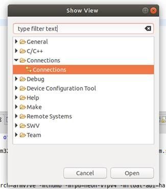

Following description of setup of debug session uses ethernet connection, so as a first step obtain ip adress of DK2 (eth0 or usb0 in case of ethernet via usb).

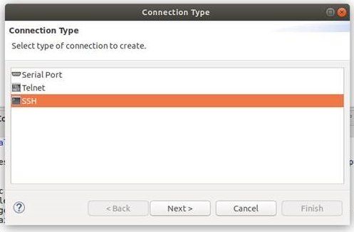

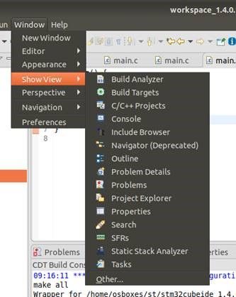

Setup a new SSH session
Windows > Show View > Other > Connections

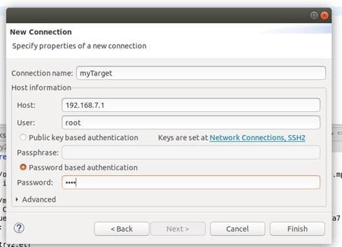

The connection name will used later in debug session, host ip is the one obtained earlier, both User and password is root

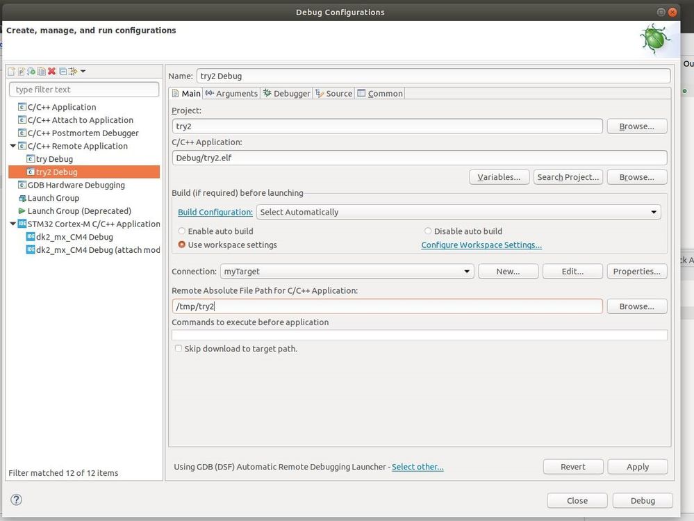

Then start debug configuration:
As connection use previous one,
And path on DK2, where your code will be placed and debugged

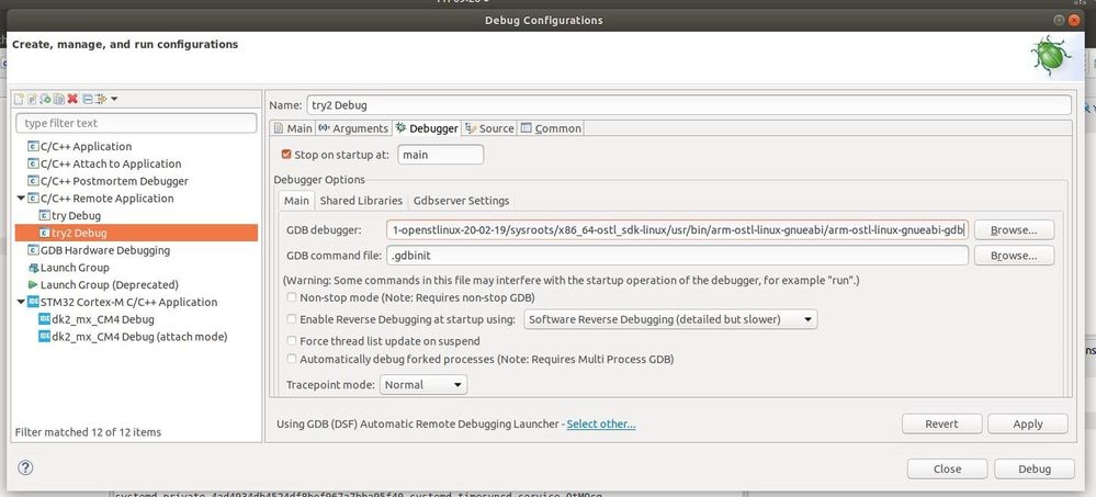

As last step insert path to GDB debugger
( in SDK in developer package), e.g. /home/osboxes/STM32MPU_workspace/STM32MP15-Ecosystem-v1.2.0/Developer-Package/SDK/sysroots/x86_64-ostl_sdk-linux/usr/bin/arm-ostl-linux-gnueabi/arm-ostl-linux-gnueabi-gdb
GDB command file leave as it is

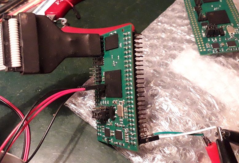

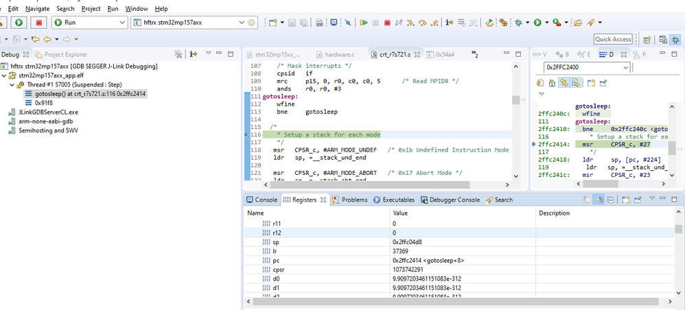

If you use J-Link and bare-metal environment - A7 core debugging is work (with few strange effects like all pins toggle in my case).
r7s7... - is a start-up code name from Renesas A9 processor with enough functionality.
ST-Link can not help in this job.
NOTE: memory addresses on picture are wrong for loader, only one value valid for region start -
0x2FFC2500. I am stops on this problem around half of month

Hello Genadi,
Yes, It seems that you are running a bare metal project on A7 core. It's exactly what I want.
But I'm confusing, which type of debug probe is using from you? I see in the picture it's a JLink probe.
Are you using an EV board? Because I'm using a DK2 and can't find the way to connect JLink to the board.
If you worked successful, could you guide me do that, please?
Thank you.

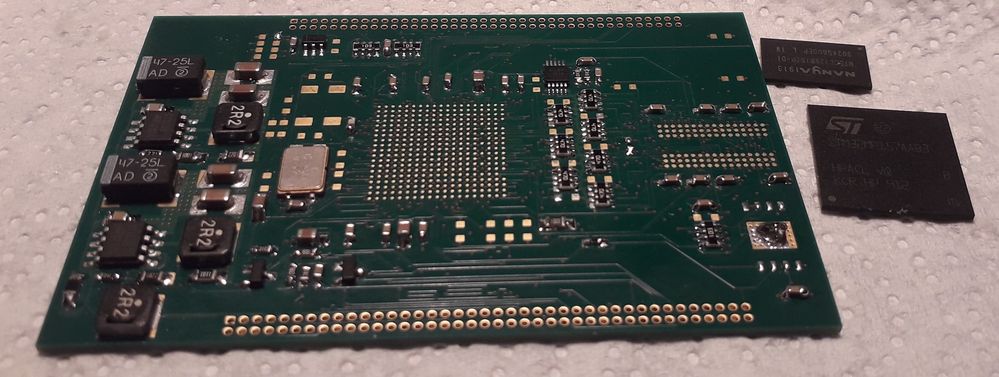

Mainly I use only debug prints, less - SWD or JTAG debug over JLink. ST-Link can not help in this job.
Now I try make new board. Both boards are six-layer.
2020-04-14 11:53 PM
I understand. It's definitely that I need solder an external header to connect to JLink probe.
Thanks for your explanation.
2020-04-15 12:06 AM
Not any JLink versions supports SWD debugging of Cortex-A cores. Diagnostics about this are show pop-up message at connection time.
