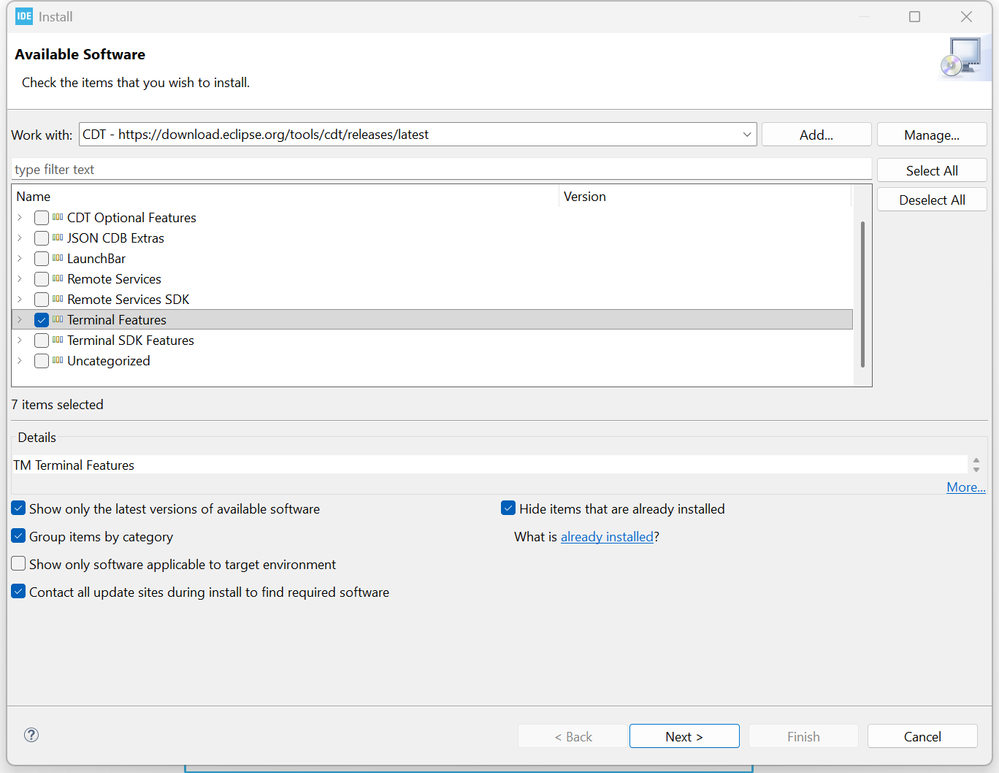

2025-10-09 7:48 PM
Got the same probelm. But I found the following link works for me:
CDT - https://download.eclipse.org/tools/cdt/releases/latest

2025-09-24 11:56 PM
I have got the same error and I fix it by install "terminal features", following these steps:
go to:
help--> install new software
then type "https://download.eclipse.org" in "work with" textbox.
You should select "Remote services" items, then click on "next" button and follow the installation steps.

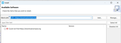

2025-09-25 7:30 AM
Thanks for reply.
If I type the link I have:
Ste
2025-10-09 7:48 PM
