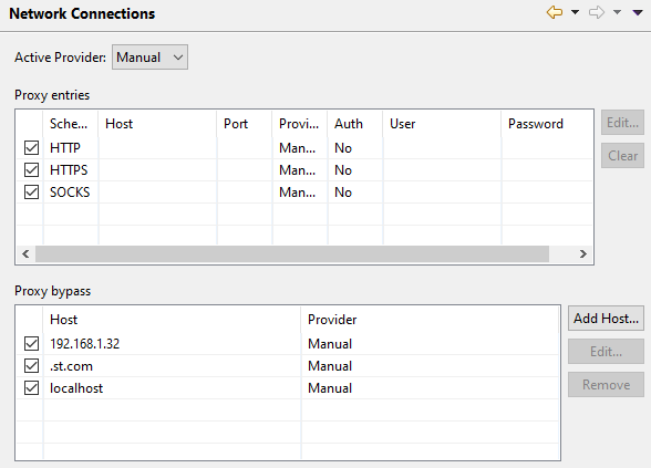

2020-05-18 3:16 AM
Hi @MDzie.1 ,
In my case I had to change connection settings and add proxy bypass of the board.
Could you verify on your side?
Milan

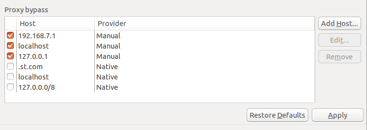

I have the same issue as @MDzie.1 but I didn't manage to solve it. I connected the board with an ethernet over USB connection. ifconfig on board shows 3 interfaces: usb0, loopback and eth0. Since, it didn't work I changed connection settings and addedd proxy bypass of the board as follow. Hower it still doesn't work "Inet address 192.168.7.2 is not reachable".

Hi @jb.1 ,
The address 192.168.7.2 is indeed strange - should be 192.168.7.1.
What addresses do you see running ifconfig? Could you provide it?
Do you use proxy? (https://wiki.st.com/stm32mpu/wiki/How_to_avoid_proxy_issues)

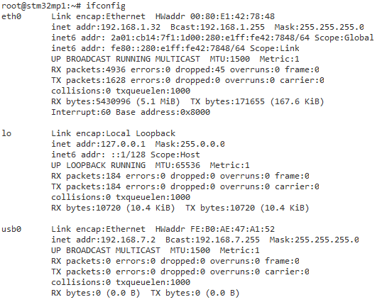

2020-06-05 8:19 AM
With the ifconfig command I have, the following result. I don't use a proxy. For information, when I connect STM32MP1 with Ethernet and I configure the network connection as follows, it works.
