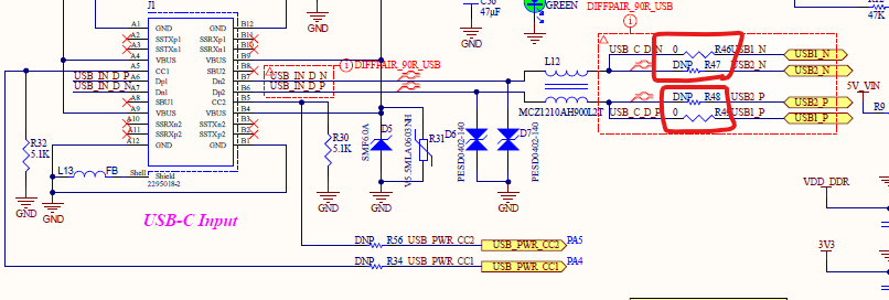

We built a customised board based on the stm32mp175c-dk2, with some changes, one of which was the addition of two USB type-c connectors.
When I try to use the USB in DFU mode, everything works fine, as long as the boot switch is turned off. When I turn the switch on, my computer does not "see" the USB at all. The same image is used on both the stm32mp175c-dk2 and our board. My computer sees the USB in stm32mp175c-dk2, but our board does not.
Anyone who can help me with this problem, as I am unable to establish an ssh connection using ethernet-over-usb?

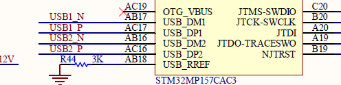

I want to usb USB_DM/P 2
in our connector I have change the DNP resistors to use USB 2 instead of USB 1
