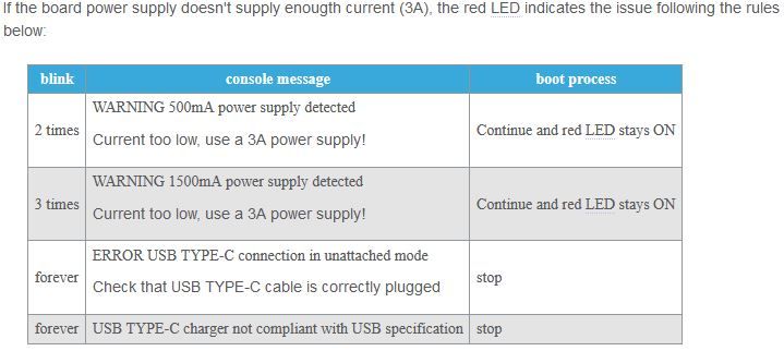

If 5V 3A capabilities is not detected at board startup, it will work, but you will have warning message (on ST-LINK VCP console) and red led blink showing the limitation (see on wiki, snapshot below).
This is a warning as, for a too weak charger, you can experience voltage drop and ultimately a board reset (e.g. if you connect some power hungry devices on USB Type-A ports).
