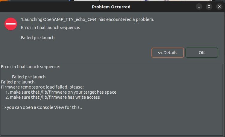

I have built a custom image using the Yocto project in the Dunfull branch. However, when I try to upload my code to M4 Core in production mode, it shows me this error message. However, I am able to connect to my board through SSH. So I believe it is not a connection issue, and I have tested on the STM32MP157C-DK2 and it does not work either.
I have tested the same procedure on openstlinux Yocto Dunfull, and it worked fine. I am thinking that something is missing in kernel configurations.
I am using Linux version 5.10.116 (oe-user@oe-host) (arm-poky-linux-gnueabi-gcc (GCC) 9.3.0 , GNI ld (GNU biutiles) . 2.34.0.020200910 ) #1 SMP PREEMPT sun May 15 18:00:09 UTC 2022

Hello @Najib Kassab,
On which OS do you use CubeIDE ? Linux or Windows ?
I already faced some similar issue, and see below what you can test:
I hope that this information can help you.
Kind regards,
Erwan.

Hi @Erwan SZYMANSKI
I have tried what you've told me, but nothings seems to work with this problem, S I switched again to starter package of opstlinux and it works.However, I still have no idea why.
thanks
