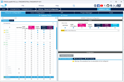

I have a custom board based on STM32MP257F-EV1 but with an eMMC (4 bits) connected on SDMM1.
I have modify CubeMX configuration accordingly:
I have also modify the device tree to declare the eMMC on SDMMC1:
