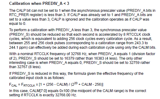

this behavior is explained because our SW does not use default values and sets PREDIV_A = 0 and PREDIV_S = 32767 (to allow better accuracy on Linux time restore on low power modes exit as subsecond granularity is linked to PREDIV_S).
See relevant RTC section to calibrate in that case:

Thanks, now it makes sense!
