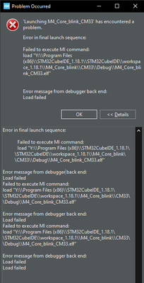

I also get this 'Problem Occurred' popup after running my debugger:

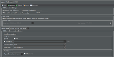

I've configured my debugger to this (connect under reset) and made some progress where my Debugger started connecting but then disconnecting (see above logs) whereas before it was never connecting:

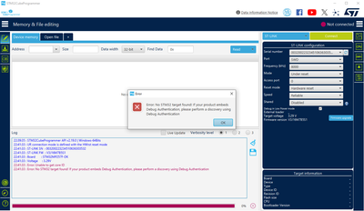

When I go into my CubeProgrammer, and try to connect:

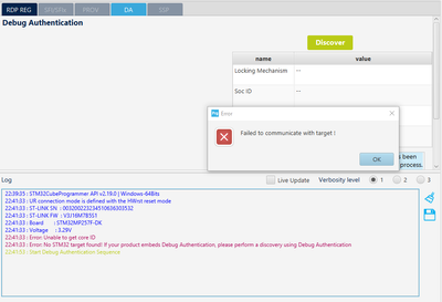

And then go to Debug Authentication to 'Discover' I get:

Hi @picklesandpears,
please find STM32MP257F-DK getting started at the following link
https://wiki.st.com/stm32mpu/wiki/Getting_started/STM32MP2_boards/STM32MP257x-DK
this includes all the necessary steps.
Standalone debug of M33 is not supported in the current software package and linux booting is must.
