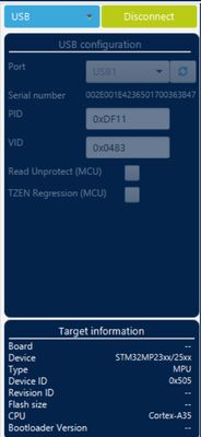

On the connected to cube programmer, I have tried flashing in the GUI and in the Terminal, and if I connect in the GUI then try to flash in the terminal it doesn't work saying target device not found. Either way the Programmer seems to work.

You mention that CubeProgrammer GUI should does not connect. Please check you use 'USB' in the blue dropdown box.
