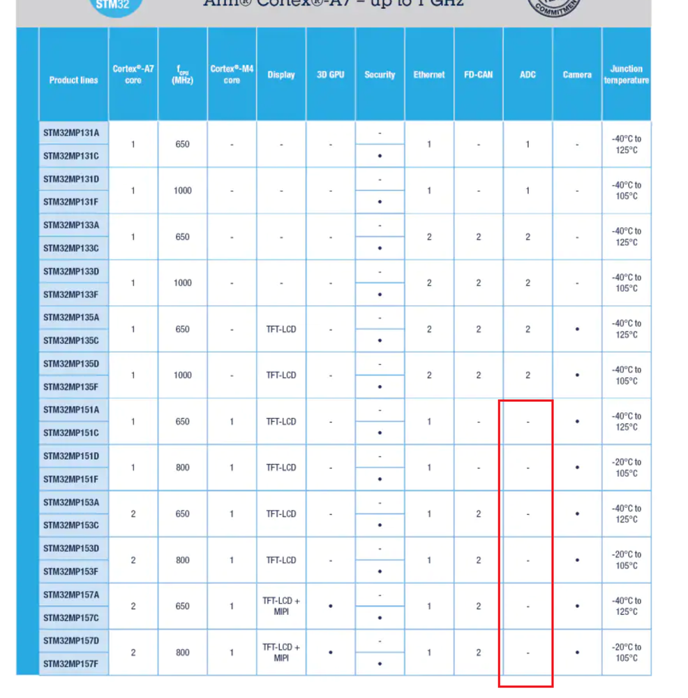

Datasheet says STM32MP15xx has ADC but here seem no ADC.
I am not sure if I am missing something.

HI @Community member ,
I confirm the typo on the table you captured. Thanks for pointing it.
I will ask for correction, probably a mix-up between STM32MP15x (2x16-bits ADCs) and STM32MP13x (2x12-bits ADCs).
Note that product selector is showing ADCs on all products as expected:
https://www.st.com/en/microcontrollers-microprocessors/stm32mp1-series/products.html

Hi, I am still not clear about the answer.
What do you mean "only MP4 has access to ADC - because security reasons"
I am using STM32MP151 and can read adc just fine from prompt command, but the table says no ADC.
Can you please give me a bit more information?
2023-05-04 8:13 AM
