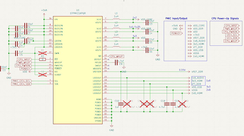

I did not build linux kernel yet. I want to check PMIC's 1.35v output in current step, because I've read somewhere in ST wiki that works when TF-A is flashed.

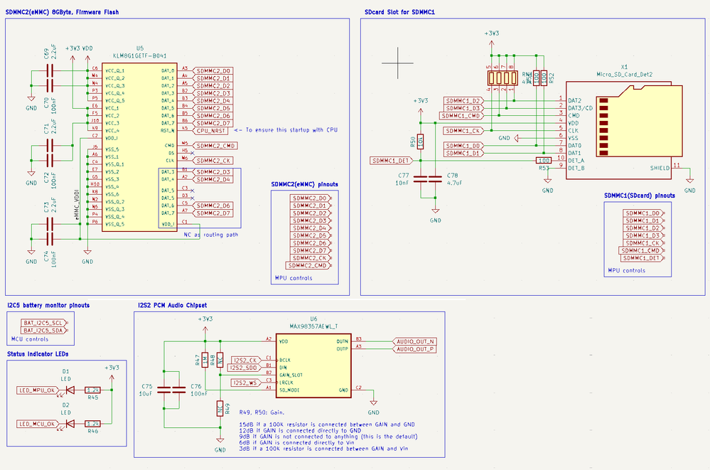

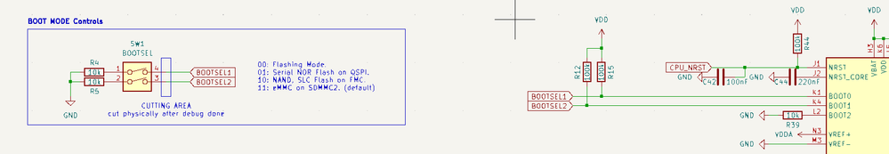

Schematics:

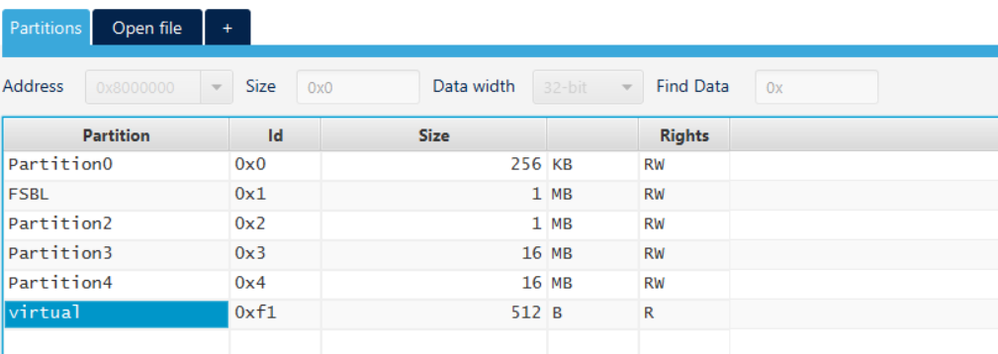

eMMC recognition problem.
No partitions are related for eMMC. should I flash first partition and FSBL?
Or how can I check this problem?

PatrickF
did you load a correct flashlayout file to CubeProgrammer ?
https://wiki.st.com/stm32mpu/wiki/STM32CubeProgrammer_flashlayout#e-E2-80-A2MMC
Here is an example on how to flashload a board (here it is SD-Card, but will be similar for eMMC, apart different flashlayout file)
https://wiki.st.com/stm32mpu/wiki/Getting_started/STM32MP1_boards/STM32MP157x-EV1/Let%27s_start/Populate_the_target_and_boot_the_image#Populate_the_SD_card
