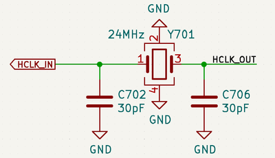

My crystal specs:

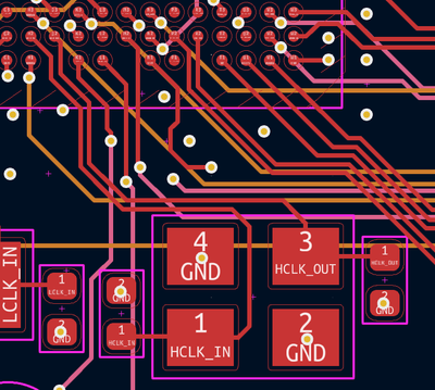

I have attached schematics and PCB connections with the crystal below (HCLK_IN goes to PH0 and HCLK_OUT to PH1)
What could be causing the HSE not to lock?

just guessing: 30p seem hight to me for 24M crystal; i would try some like 2x 18 pF .

I confirm that 30pF is huge, using a 24MHz crystal with 20pF load seems also high.
On our AN5031, we give example with 2x6.8pF using NX2016SA 24 MHz crystal (8pF crystal load spec).
Routing seems perfectible. Crystal must have ground plane and short wires without any other signals crossing around.
Please have a look to AN2867 for routing guidelines and also to choose right crystal specs and compute load capacitance.

I end overlooking the load capacitors. I use the C=2*(CL + Cstray) formula to get those, but probably forgot to divide the value by 2 (with 5pF as stray, that would give 25pF).
I will try changing those to 12pF and will post the results.

by computation for a Crystal with CL=20pF, assuming CStray = 4pF, I end up to CL1=CL2=32pF .
But this crystal might not oscillate because the transconductance (gm) required is too big (assuming C0=5pF, I end up to 2.3 mA/V) versus HSE datasheet (max 1.5 mA/V).
With crystal from AN5031 (NX2016SA, CL 8pF, 80 ohms, C0 = 1pF), gm is 0.6mA/V (so below the max of 1.5 mA/V).
If you put smaller capacitor on your 20pF crystal, it might oscillate as you reduced gm value, but then you are not using the crystal within its specified load, so I don't know what could the impact (for sure some frequency error).

I can confirm those. Reducing load capacitors allow HSE to lock on TF-A. But, by the time u-boot is loaded, there is too many frequency errors. Serial has multiple wrong characters and peripherals are not working. Gonna try ordering some new 24MHz crystals and matching capacitors and try it out.
First, in the formula one has to multiply, not divide. Second, the formula is wrong. The correct one is:
C = 2 * (CL - Cstray)
Therefore for a CL = 20 pF and Cstray = 5 pF, the capacitors should indeed be C = 30 pF. If it doesn't start because of other factors, then you have to use a different crystal. Not respecting the load capacitance requirement leads to frequency accuracy going significantly out of specification:
