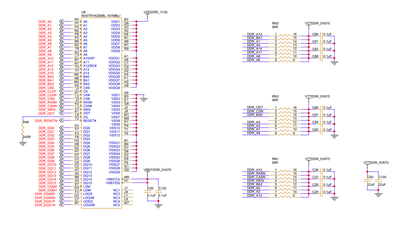

This is our VTT resistor, please explain this VTT resistor usage and why it is placed? explain sir?

VTT resistor are termination resistors used to avoid signal reflections on Address/Command lines of the DDR.
This is mandatory when there is 2 x DDR3L (i.e. x32 bit) and optional when there is a single DDR3L (x16 bit).
You could try unsoldering all the related resistors (RN1, RN2 and RN3), it might still work (if PCB routing is sufficiently good) with less consumption (around 200mW gain). But a PCB update is needed in the end to remove the stubs going to the removed resistors and VTT related lines/components, as well a SW update to remove unused VTT supply enable.

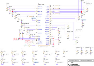

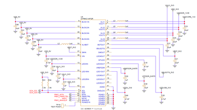

For LDO input voltage of STPMIC1, you could sometimes use another buck output (i.e. 3.3V) if LDO output voltage if lower (e.g. 1.8V). then you reduce the wasted power as you partly benefit of the Buck efficiency.
This is the case for LDO1/LDO6 on our DK2 board

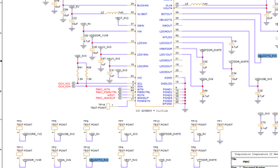

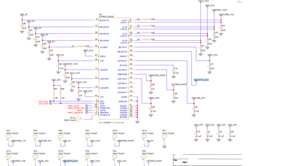

we are using this connections of STPMIC used sir., Its ok or Not for LDO connections sie?

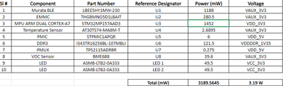

This is our Board subsystem Consumes the power dissipation.
Sir Please clarify, To reduce the resistance value of some IC's in the board, power dissipation will be decreased or not sir? i think it will be decreased. but how to reduce the resistance value in generally? please clarify this final question sir... I'm waiting for your positive responses.
if I read well the table above, the consumption on VDD_3V3 is 440mA, which is quite huge (the absolute maximum rating in datasheet is precisely 440mA). If you really measure 440mA on your board, then there is likely some issues (IO conflict or else).
Is it measurements or just estimates from datasheets ?
You should do measurements on your board to understand where the (abnormal) power/heat is generated. This could be done by measuring current (if there is connections for that). alternatively, thermal camera could help a lot as well to focus on where most heat if generated.
By experience, 1000mW on heavy loaded STM32MP15 (mostly on VDDCORE) is possible and Tj=96C is also acceptable with small board and small package. Single DDR3L could be 250mW, DDR terminations could be 200mW. STPMIC1 efficiency is somewhat above 80%, so some hundred of mW dissipated on STPMIC1 should be expected as well. For other components, I cannot state.
Please clarify which issues you are facing (hot board is normal if really using 1.33A/5V=6.7W on a small board, but this power should not come only from MP15).

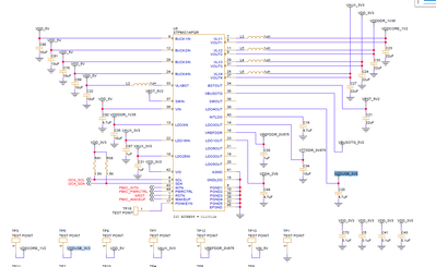

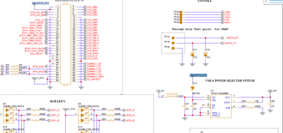

One more doubt, sir. We are using this above PMIC in our processor board; here the TP4 and TP5 test point output voltage drop comes to 0V. Why is it coming to 0V, sir? Please explain this issue, sir and how to fix this issues sir?    I also attached where its voltages are going to other components in the processor board for your reference, sir.
TP5 - test point voltage drop out flows.
TP4 - test point voltage drop out flows.
Marudhupandian_3-1723627269639.pngMarudhupandian_4-1723627299972.pngMarudhupandian_5-1723627302645.pngMarudhupandian_6-1723627305547.png
Sorry for the inconvenience sir., i attached wrong TP10 test point images in previous message...here i attahed TP4 test point voltage drop out images for you reference sir.
