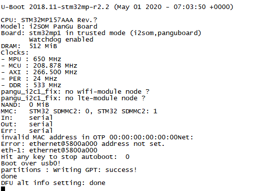

No information comes from UART4 after turn on power switch.

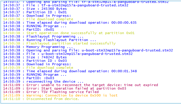

I change the boot-switch to '000' and use "cube programmmer " to update boot.
some information comes out form uart4 but "cube programmmer " show error.
SO,please tell me how to update boot-part or our hardware has been damaged Permanently.
