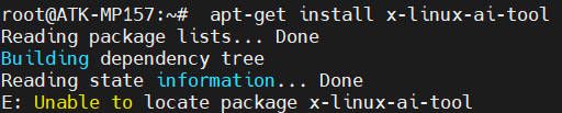

I am a newcomer and not very good at using Linux. I hope to try running the model on the device. I am using a third-party development board. Is the tutorial on the official website applicable or can I use an API

according to prompt I see on your capture, not sure you are using an ST Board with openSTLinux Starter Package.
For OpenSTLinux Starter Package, please see https://wiki.st.com/stm32mpu/wiki/X-LINUX-AI_Tool

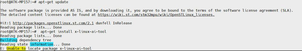

Did 'apt-get update' works ?
I'm not expert, but if needed, the following link should help to build X-LINUX-AI for your board.
see https://wiki.st.com/stm32mpu/wiki/X-LINUX-AI_Developer_package or https://wiki.st.com/stm32mpu/wiki/X-LINUX-AI_Distribution_package
Regards.
2024-10-03 11:49 PM
I am not using the openSTLinux Starter Package, I am using a third-party development board and I am concerned that flashing this package may not work properly. I am looking for other ways to call the library
2024-10-03 11:58 PM
Hi @wink
the x-linux packages installers are provided through the «updates» component of the OpenSTLinux distribution. This component has to be built separately.
Details are given here:
https://github.com/stmicroelectronics/meta-st-pkgrepo-updates
Best regards,
--JM
