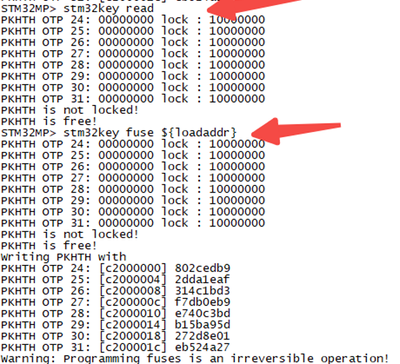

Yestarday I fuse the OTP PKHTH as follow
But today I found the key I fuse is not the correct one. So I want to re-fuse the OTP ,it seems that can't no fuse again. is there any way to fuse the OTP this situation?

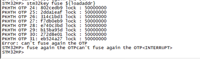

2024-07-17 2:05 AM
2024-07-17 2:48 AM
From that page, you could see
0x10000000 is "Shadow write sticky lock"
0x50000000 is "Shadow write sticky lock" + "Permanent write lock"
Regards.
