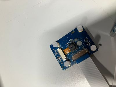

I am trying to capture images from OV5640 on STM32MP135F-DK.
When I connect GC2145 camera, I succesfully list devices like below:
I removed GC2145 on the ST camera board and connected OV5640, like below image:
But when i try to list devices, /dev/media0 is not visible. How can i get images from OV5640?

Hello @alpka ,
By default, the board device tree of STM32MP135F-DK board configure the Galcore camera and not anymore the OV5640. But it is very simple to switch by modifying the device tree. Please see below :
In arch/arm/boot/dts/stm32mp135f-dk.dts in Linux sources, you will see :

Please change the status of ov5640 from disabled to okay and the one of gc2145 from okay to disabled.
