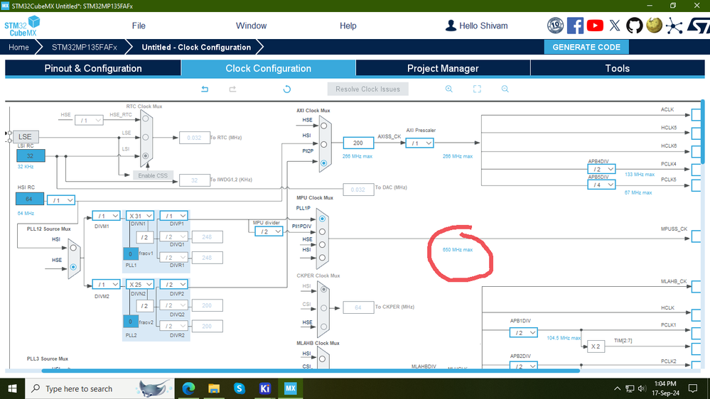

I'm unable to set the clock frequency above 650Mhz, but according to the datasheet, the mpu i selected should be able to reach 1000mhz. What am I doing wrong?

I simply select STM32MP135FAF7 in the MCU selector, then "create new project", then enable HSE and set it to 16 Mhz in the Clock configuration sheet. Then updated a bit the various settings of PLL to match your screen shot.
I always could see max 900 Mhz in the MPUSS_CK
JM
2024-11-12 11:02 AM - edited 2024-11-12 11:02 AM
I'm having the same problem as the original poster when trying to set up a bare metal project for the STM32MP135F-DK or just STM32MP135FAFx. Using the latest CubeIDE or CubeMX. The HSE is 24Mhz on the board, so that is what it is set to.
I presume there must be some other setting to enable this to go up to 1000MHz? But I can't see what that would be.
