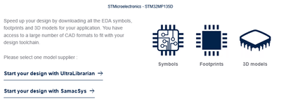

You could generate symbol and footprint of STM32MP135Dxx for your favorite CAD format from this link:
https://www.st.com/en/microcontrollers-microprocessors/stm32mp135d.html#cad-resources
