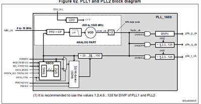

Exception mode=0x00000016 at: 0x2ffe588fConfiguration files are generated from STM32CubeMX 6.9.1 project and I noticed strange values for DIVR2 PLL that is used after by DDRPHYC. Values are with comma and I don't understand why 24MHz / 3 (DIVM2) x 66 (DIVN2) / 2 (figure 61 RM0475 Rev 1) / 1 (DIVR2) = 530.666922 instead of 264 MHz.

I agree that CubeMx PLL1/PLL2 drawings are slightly misleading, but the reported frequencies values are accurate.
There is a /2 inside the PLL1 and PLL2, but as this /2 is within frequency loop, it is not impacting output frequency calculation (but VCO run twice faster than PLL3/PLL4 with same DIVN to get better duty cycle).
Note that if FRACV is different than 0, you should take it into account.
(note that DIVM/DIVN/DIVP in CubeMx are real division factor and does differ by 1 from DIVM/DIVN/DIVP in Device Tree/Register or RefMan formulas)
With HSE=24MHz and DIVM2=3, you get Fref_ck = 8MHz
Then with DIVN2=66 and FRACV=2731, FVCO = 1061.334 MHz
Which result on DDR clock of 530.667 MHz (with DIVR=1)
Regards.
